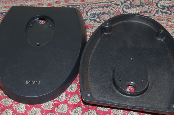

The base is made of cast iron. Â It is freaking heavy. Â Powered coated in either black or gray to match the hollow aluminum and sand or shot fillable pillar, and steal top plate.

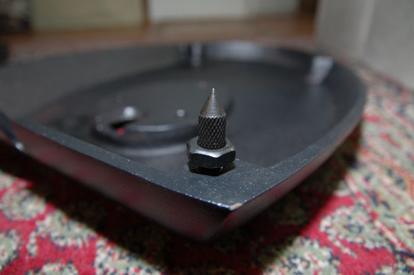

Construction is very easy.  All the screws fit in to place correctly.  The overall  manufacturing on the pair I got is good but not perfect.  One foot spike placement wasn’t created as deep as all the others.  So that spike’s fully reduced position is higher than all the other.  Which means, if you didn’t want to take the spike out and reduce the thread length with a file and some elbow grease, to even out the feet for a starting position, all screws would be a bit higher in position. And adjustments would thus be more limited.  But like I said, put the spike in a vice, file it down some, and you are good to go.  The manufacturing is done in China, and VTI is aware that sometimes there are quality control issues.  I’m sure if you called them up and asked for a replacement of anything that isn’t correctly made they would be happy to help.  As long as you yourself didn’t cross thread anything in construction.
